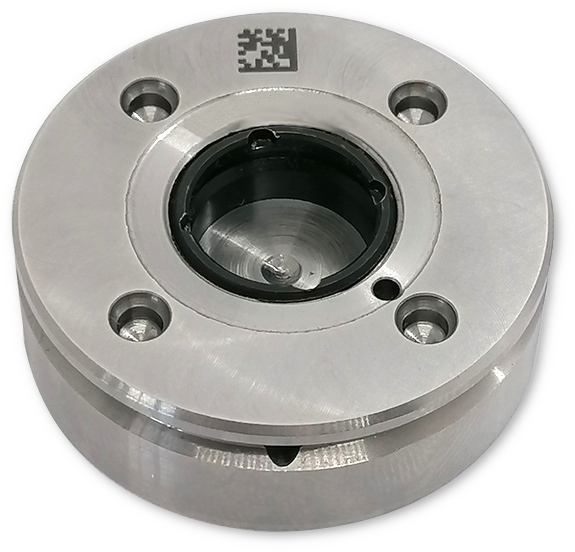

Base palett to process under desired geometry
Unhardened steel
  • Desired Dimension
Draft palett Micro5
Centering the X and Y system
The system is composed of a spring blade under the chuck or pallet fixed by the 4 support feet. During locking, the 4 hard metal balls and the deformation of the blade ensure the positioning in zero reference of all axes with an accuracy of 2μm.
Air supply
The system uses the support screws as an air supply channel for the various functions of the cleaning chucks for clamping and unclamping of parts.
3D (36x12mm)
3D (54x12mm)
Pneumatic ball lock
The descent of the piston forces the balls against the cone of the screw ring and thus compresses and stiffens the chuck or vane on its base. This with a free passage in the center always free, to allow the mounting of a tie rod or a plunger.
Cleaning of Z-references
By air jet to guarantee precision in any case.
3D (36x35mm)
3D (54x35mm)
QR-code
Each product is identified to allow tracking and automation.
